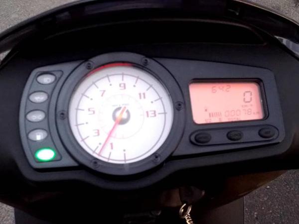

Er der nogle herinde som ved, hvordan man indstiller uret på en piaggio nrg power dt?
P.S Har vedlagt et billede, hvor man kan se uret øverst i det digitale speedometer.

    #1   29. nov 2016 Kan du bruge det her mon:
    Setting the hour/minutes function To set the clock, hold down the «CLOCK» button for more than three seconds. The numbers representing the hours will start blinking. Set the hours using the «SET» button. By pressing the «CLOCK» button again the numbers representing the minutes will start blink- ing. Set the minutes using the «SET» button. Press the «CLOCK» button again to exit the setting mode. The setting mode is terminated automatically if, during the setting, no button is pressed for a period longer than 8 seconds, and the last set time will be shown on the display.
